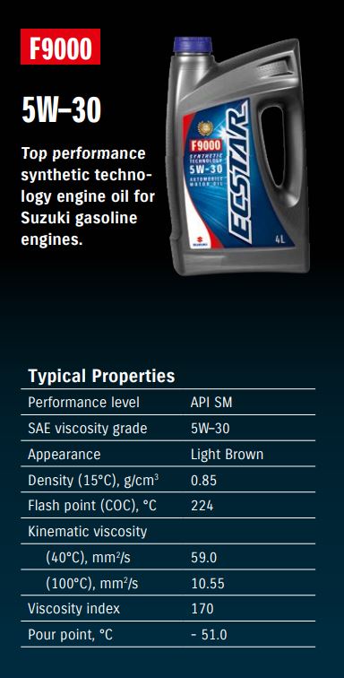

« Răspuns #249 : 19.Mar.2023, 06:20:47 p.m. »
enjoy
